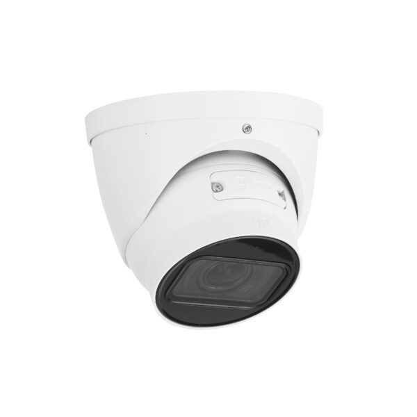

IPC-T54IR-ZE-S3 4MP IR Vari-focal Eyeball Network Camera
  • 4-MP 1/1.8″ CMOS image sensor, low luminance, and high definition image.
  •  Outputs max. 4MP (2688×1520) @25/30 fps.
  • Built-in IR LED, and the max. illumination distance is 40 m.
  • ROI, SVC, SMART H.264+/H.265+, AI H.264/H.265, encoding after filter, flexible coding, applicable to various bandwidth and storage environments.
  • Rotation mode, WDR, 3D NR, HLC, BLC, digital watermarking, applicable to various monitoring scenes.
  • With deep learning algorithm, it supports: video metadata, IVS, face detection, smart object detection, and people counting, etc.
  • Supports max. 512 GB Micro SD card, built-in MIC.
  • 12 VDC/PoE power supply; ePoE.
  • IP67 protection.
  • SMD 3.0.
Camera
  • Image Sensor: 1/1.8″ CMOS
  • Max. Resolution: 2688 (H) × 1520 (V)
  • RAM/ROM: 4GB/1GB
  • Scanning System: Progressive
  • Electronic Shutter Speed: Auto/Manual 1/3 s–1/100,000 s
  • Minimum Illumination:
    • 0.0007 lux@F1.8 (Color, 30 IRE)
    • 0.0004 lux@F1.8 (B/W, 30 IRE)
    • 0 lux (Illuminator on)
  • S/N Ratio: >56 dB
  • Illumination Distance: 40 m (131.2 ft) (IR LED)
  • Illuminator On/Off Control: Auto/Manual
  • Illuminator Number: 2 (IR LED)
  • Angle Adjustment
    • Pan: 0°–360°
    • Tilt: 0°–78°
    • Rotation: 0°–360°
Lens
  • Lens Type: Motorized vari-focal
  • Mount Type: φ14
  • Focal Length: 2.7 mm-12 mm
  • Max. Aperture: F1.8
  • Field of View: Horizontal:
    • H: 115°–47°;
    • V: 62°–27°;
    • D: 137°–54°
  • Iris Type: Auto
  • Close Focus Distance: 1.5 m (4.92 ft)
Intelligence
  • IVS (Perimeter Protection): Intrusion, tripwire, fast moving (the three functions support the classification and accurate detection of vehicle and human); loitering detection, people gathering, and parking detection
  • Smart Object Detection: Smart abandoned object; smart missing object
  • SMD 3.0: Less false alarm, longer detection distance
  • AI SSA: Yes
  • Face Detection: Face detection; track; snapshot; snapshot optimization; optimal face snapshot upload; face enhancement; face exposure; face attributes extraction including 6 attributes and 8 expressions; face snapshot set as face, one-inch photo or custom; snapshot strategies (real-time snapshot, quality priority and optimization snapshot); face angle filter; optimization time setting
  • People Counting: Tripwire people counting, generating and exporting report (day/week/month/year); people counting in area and queue management, generating and exporting report (day/week/month); 4 rules can be set for tripwire, people counting in area and queue management.
  • Heat Map: Yes
  • Video Metadata:
    • Motor vehicle, non-motor vehicle, face, human body detection; track; snapshot; snapshot optimization; optimal face snapshot upload.
    • Motor vehicle attributes: vehicle type, vehicle color, vehicle logo and other attributes : seatbelt, smoking, calling.
      Non-motor vehicle attributes: type, color, number of people, top type and color, hat.
    • Human body attributes: gender, top/bottom type and color, bag, hat and umbrella.
    • Face attributes: gender, age, expressions, glasses, face mask and beard.
  • Smart Search: Work together with Smart NVR to perform refine intelligent search, event extraction and merging to event videos
Video
  • Video Compression: H.265; H.264; H.264H; H.264B; MJPEG (Only supported by the sub stream)
  • Smart Codec: Smart H.265+; Smart H.264+
  • AI Coding: AI H.265; AI H.264
  • Video Frame Rate:
    • Main stream: 2688 × 1520 (1 fps–25/30 fps) /1920 × 1080 (1 fps–50/60 fps)
    • Sub stream: D1@(1–25/30 fps)
    • Third stream: 1080p@(1–25/30 fps)
    • Fourth stream: 720p@(1–25/30 fps)
  • Stream Capability: 4 streams
  • Resolution:
    • 4M (2688 × 1520);
    • 3.6M (2560 × 1440);
    • 3M (2048 × 1536);
    • 3M (2304 × 1296);
    • 1080p (1920 × 1080);
    • 1.3M (1280 × 960);
    • 720p (1280 × 720);
    • D1 (704 × 576/704 × 480);
    • VGA (640 × 480);
    • CIF (352 × 288/352 × 240)
  • Bit Rate Control: CBR/VBR
  • Video Bit Rate: H.264: 32 kbps–16384 kbps; H.265: 12 kbps–11008 kbps
  • Day/Night: Auto(ICR)/Color/B/W
  • BLC: Yes
  • HLC: Yes
  • WDR: 140 dB
  • Scene Self-adaptation (SSA): Yes
  • White Balance: Auto; natural; street lamp; outdoor; manual; regional custom
  • Gain Control: Auto
  • Noise Reduction: 3D NR
  • Motion Detection: OFF/ON (4 areas, rectangular)
  • Region of Interest (RoI): Yes (4 areas)
  • Image Stabilization: Electronic Image Stabilization (EIS)
  • Smart Illumination: Yes
  • Defog: Yes
  • Image Rotation: 0°/90°/180°/270° (Support 90°/270° with 4M (2688 × 1520) resolution and lower)
  • Mirror: Yes
  • Privacy Masking: 8 areas
Audio
  • Built-in MIC: Yes
  • Audio Compression: G.711a; G.711Mu; PCM; G.726; G.723
Network
  • Network: RJ-45 (10/100 Enhancement Base-T)
  • SDK and API: Yes
  • Protocol : IPv4; IPv6; HTTP; TCP; UDP; ARP; RTP; RTSP; RTCP; RTMP; SMTP; FTP; SFTP; DHCP; DNS; DDNS; QoS; UPnP; NTP; Multicast; ICMP; IGMP; NFS; SAMBA; PPPoE; SNMP; P2P
  • User/Host: 20 (Total bandwidth: 80 M)
  • Storage : FTP; SFTP; Micro SD card (support max. 512 GB); NAS
  • Browser :
    • IE: IE 9 and later
    • Chrome: Chrome 102 and later
    • Firefox: Firefox 88 and later
  • Mobile Phone: IOS; Android
Power
  • Power Supply: 12 VDC/PoE (802.3af)/ePoE
  • Power Consumption : Basic: 3.5 W (12 VDC); 4.5 W (PoE)
    Max. (H.265+ WDR+ Intelligence on+IR on): 6.7 W (12 VDC); 8.2 W (PoE)
Structure
  • Casing Material: Metal
  • Product Dimensions: 108.3 mm × Φ122 mm (4.26″ × Φ4.80″)
  • Net Weight: 0.70 kg (1.54 lb)
  • Gross Weight: 0.96 kg (2.12 lb)
